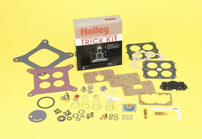

Si les papillons sont coincés il faut démonté le carbu je suppose!
Au Us chez qui je peux commander un kit refection car si je l'ouvre autant le refaire. C'est un 4779-6 type 4150 ou 4160 je sais plus.
HLY-37-933 $79.88
Estimated Ship Date: Monday
Application Show All
Brand: Holley
Product Line: Holley Trick Kits
Rebuild Kit Type: Trick kit
Quantity: Sold as a kit.
Carburetor Rebuild/Trick Kit, Holley 2300/2305/4150/4160/4165/4175/4180/4500 Models, Each
Check to make sure this part fits your application
No more fuel slosh.
These Holley Trick Kits are the inexpensive solution to fuel slosh in your carburetor. The kits contain all of the parts you need to perform a complete rebuild on your Holley carb, including a vent baffle, high-flow needle and seat assemblies, high-capacity power valves, pump cam and secondary opening spring assortments, gaskets, and O-rings. Plus, they have extra parts related to carburetor calibration that are required in order to accomplish a real performance tune. These include accelerator pump discharge nozzles and extra gaskets. A carburetor exploded view and detailed tuning guide are also included, with packaging that serves as a handy parts tray. These Holley Trick Kits have it all.
http://store.summitr...ch.asp&x=39&y=8

Merci memez,
Je pensai pas que summit faisait aussi les kits refections.
