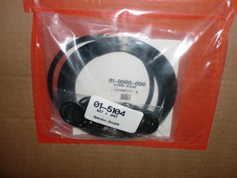

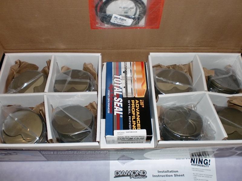

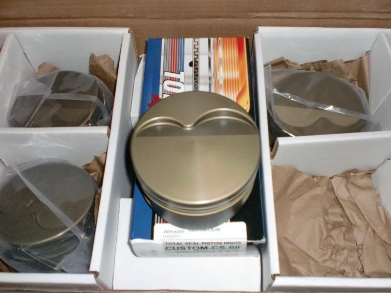

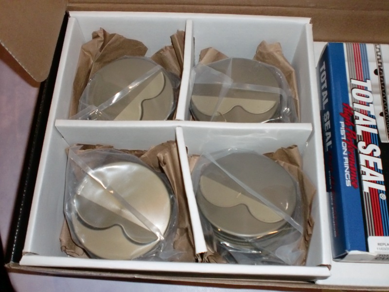

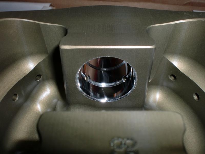

#3654 Sponge
Posté 29 November 2011 - 08:49 PM
Pistons reçus, belle bête.
#3655 57-Hervé
Posté 30 November 2011 - 07:34 PM
Sympa tes cendriers...
#3656 thor_eyerdhal
Posté 30 November 2011 - 08:24 PM
Drole de couleur les têtes de piston, c'est un traitement céramique ou un effet de lumière?
#3657 marc_spierk
Posté 30 November 2011 - 08:51 PM
Beau cendrier mais il est non fumeur. :lol:
#3658 Sponge
Posté 30 November 2011 - 09:28 PM
The other thing you will see in our pistons is they are hard anodized. This is the same procedure done to the Nitro pistons, it makes the pistons very tough and it is NOT a coating like ceramic or Teflon skirts. Minor misses in your tune that would have lifted a ring land are totally eliminated, skirts are less likely to collapse and won't scuff, unless your tune is so far out in right field you can't be seen
